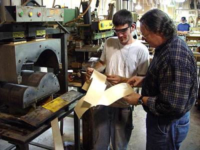

How's this for a bending jig? Gibson Montana....
Cheers,
Richard

I'm trying to figure out how the heat is applied to the wood before bending. I assume the upper and lower blocks have embedded heating elements but doesn't look like that would do it.

Nelson, I was trying to figure out the same. If the slat is placed in flat and the mold brought down you would have some pretty significant clearance between the wood and the heat source in open air.

Nelson, wouldn't that be the same concept as a fox bender with lamps, except it also would have top heat. If I post this link correctly it will take you to a video from taylor guitars on their bending process. it is two videos, zero operator interrvention, but very cool.. Check out the other vids also...

Nelson I saw a similar contraption when I toured the Gibson plant when they were still in Kalamazoo, MI. (circa 1977) Both the male and female part of the molds are heated. The wood was brought to temperature in a hot liquid bath, then quickly inserted into the mold and shazam. The one I saw even had a trimmer that cut the ribs to length after they were bent.

When I went to Larrivee back in 93' they steamed the sides first and than into something also similar, bent like butta'
